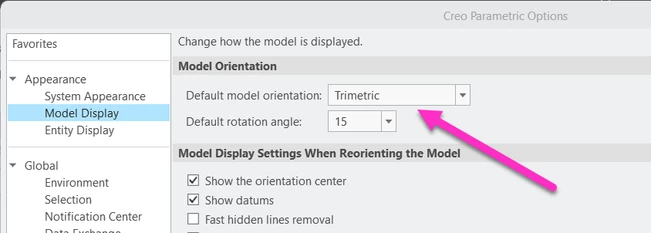

Ok, so, for a LOOOOONG time I've wanted to make 7 other iso views like the Default Orientation, but never was able to find actual information to make it work. There was some numbers I found here some time ago based on Radians....but they weren't quite correct, and that bugged the cr@p out of me. since we're revising our start models and I REALLY finally wanted to put this to bed, I FINALLY was able to find the info that I needed. In looking at it, I figured the rotation angle around the Y axis (relative to the screen) HAD to be 45deg (+ or - depending)...and it is, but what was the horizontal angle? I found the last clue here for the "True" representation (FINALLY!):
I've attached the Word doc I made, but for, say, Iso-Front-Left-Top orientation, the angles when starting from the FRONT view are:
(DEFAULT TYPE ISO VIEWS ORIENTATION ANGLES ROTATED FROM THE FRONT VIEW
(DYNAMIC ORIENT SPIN BY: SCREEN AXIS VERTICALLY THEN HORIZONTALLY)
45
35.3644
