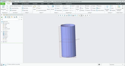

I want to create a quilt and then wrap a sketch around said quilt.

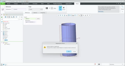

To do this, I create a circle with diameter 360/pi and then extrude the sketch to 250. I create a sketch of a rectangle with height matching the extrusion and width 72. If I set the width to be 80 the wrap is successful but if I put the width to be 72 it fails. I have no idea why and would appreciate all help.
I am using Creo parametric 9.0 Student version.

I would guess the issue is related to part of your sketch being on the very edge of the surface you are projecting onto.  As @MartinHanak indicated the entire sketch must lie within the surface.  The model has a level of accuracy that can cause an issue when you are defining the sketch to extend to the edge of the surface.  the copy of surfaces may also be contributing to the error.
On another note, I know you are a student, but this is a two feature curve created with 9 features.  Extrude the cylinder as a surface with an internal sketch and wrap an internal sketch from the front datum plane.  No need to copy surfaces and remove solids.

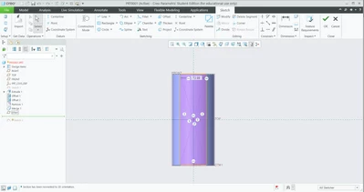

The sketch.

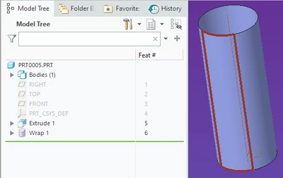

Same wrap working when I set the width to be 80 instead.

wrapped curve must lie inside surface.
Aug 2, 2023 12:21 PM UTC
I am not sure I follow in the first sketch the height was constrained by the end references while in the second sketch the wrap failed when the sketch height was 300 same as the extrude

I was able to get a failure only when using copied surfaces and some widths worked and some didn't.  If I extruded a cylindrical surface and wrapped it, it worked for all widths.
Creo 7.0.11.0, absolute 0.001,  mmKs
