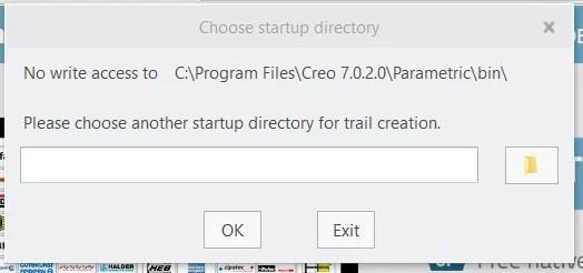

Issue starting CREO. Error: "Please choose another startup directroy for trail creation"

Hello Everyone,
I am facing an issue with the CREO parametric startup. I installed CREO in C: drive. And by default, the parametric.exe is located in the BIN folder. But firstly I do have write access in this location. And I do not understand why CREO is having this issue.
Other than that if I try changing it to another location where I have "write access", It does not accept any location in C: .
If I choose another location (let's say the same location as my working directory), it throws an error with AFX and IFX failed to load. And closes creo. I understand it should not work in theory because my working directory doesn't have parametric.psf file.
I have a student licence. I was using creo before this and recently I faced this issue.
How can I start using creo again and resolve this issue? Can anyone please help me with this?
Regards
Ayush

Windows usually doesn't let regular user to write to Program Files directory and its subdirectories; it looks like you're trying to start Creo directly by running parametric.exe from \bin directory and Creo tries to create a trail file in the directory but has insufficient write permissions.
You can try running parametric.exe as an administrator (with elevated permissions) but I wouldn't advise it. Better way is to create a shortcut to run Creo (just put it on your desktop) and define startup directory using "Start in" field in shortcut properties. Try setting "Start in" to a folder inside your documents (e.g. C:\Users\[your_username\Documents\Creo) and see if that will help.

Thanks for responding @LukaszMazur.
I understand that windows wouldn't allow writing in program folders. Thinking the same thing, I tried running with Administrator access too. This time, it didn't throw an error to choose a startup directory for trail creation. But still, it throws an error with AFX and IFX failed to load. And closes creo.
I am not starting Creo directly by running parametric.exe from the \bin directory. I have a shortcut on my desktop, which is targeted to parametric.exe in the \bin directory. And by default, the start in location is also directed to \bin directory. As you said, I tried changing it to a separate folder specifically for Creo. But again, it throws an error with AFX and IFX failed to load. And closes creo.
I did get a solution though and for now, it seems to be working. I started the "reconfigure" application in the \bin directory. It reinitiated the licence file and reconfigured it. And luckily, now it did not throw an error and ran normally. I don't understand it though.
