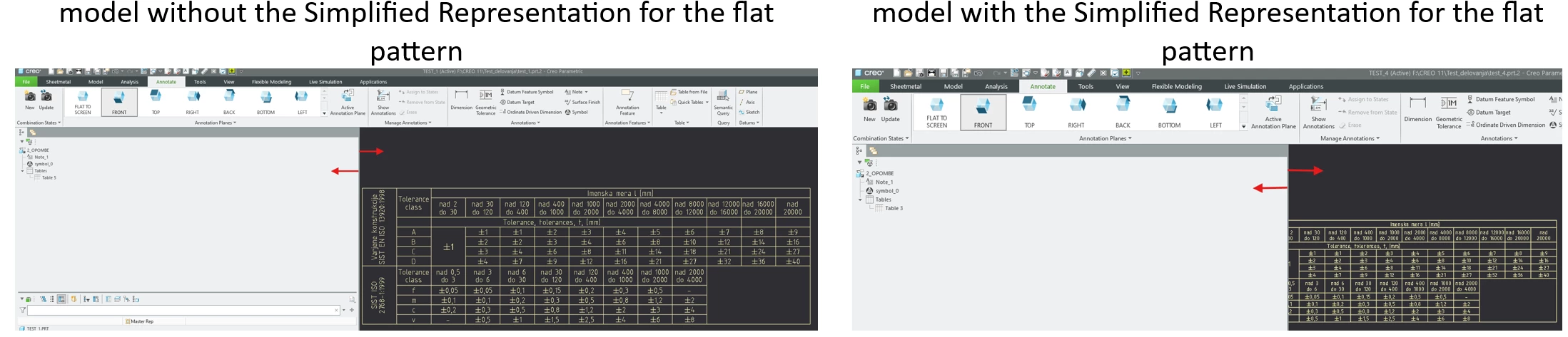

while working in Creo 11 and trying to display the sheet metal development using a Simplified Representation of the Flat Pattern, I am experiencing an issue related to Annotate tables that are set to Flat to Screen alignment.
When I create the Simplified Representation for the flat pattern and have an Annotate table added to the Combined View (aligned as Flat to Screen), the table alignment becomes incorrect after the flat pattern is generated. Specifically:
  1. When I resize the Model Tree panel, the table does not adjust or move along with the change in the Model Tree width.
    – See image 1.

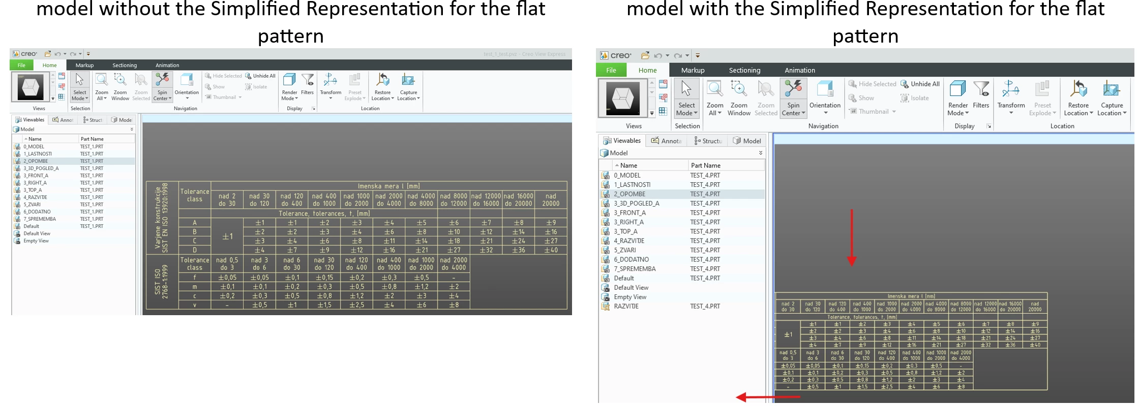

  2. When exporting the model as PVZ and opening it in Creo View Express 12, the table shifts both horizontally and vertically in the Combined View.
    – See image 2.
