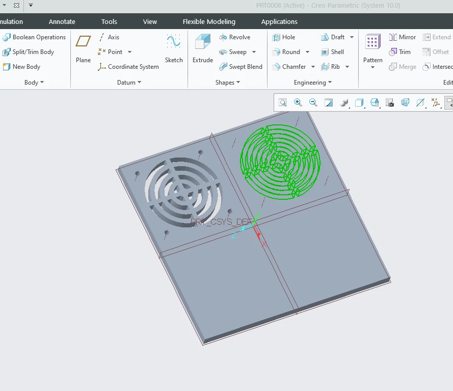

Issue with Mirroring a Feature in Creo: Original Feature Disappears
I'm currently facing a peculiar issue in Creo and could use some advice. I've created a part with a specific feature - a hole cut out. The problem arises when I attempt to mirror this feature. While the mirroring process itself seems successful, the original hole cut out disappears.
Has anyone encountered this issue before? What could be causing the original feature to vanish upon mirroring, and more importantly, how can it be resolved? Any insights or solutions would be greatly appreciated.

More info needed. State what version of Creo you are using (educational license?). Post the model with the "failed" feature.
8-Gravel
Dec 13, 2023 6:15 PM UTC
See image below
Not an education license. We have the standard one.

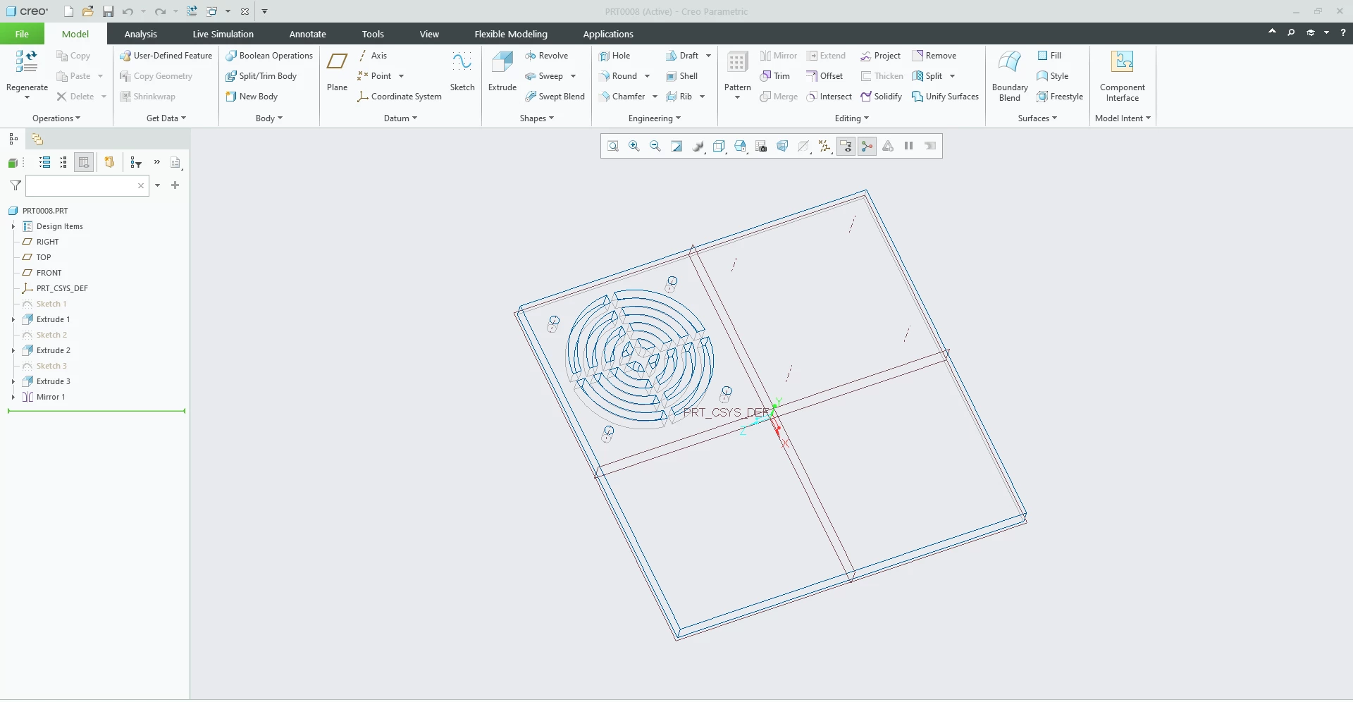

kdirth
Dec 13, 2023 5:53 PM UTC
Including the model tree in the screenshot would be helpful for us to understand how you created the part.

can you at least expand the model tree? - I am guessing that there is a mirror cutout feature there, but it "overlaps" the original.
