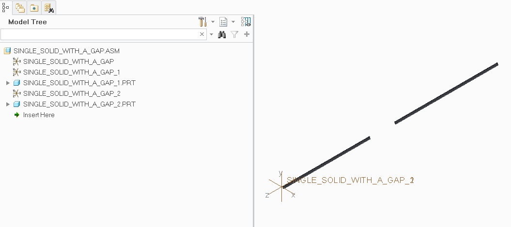

Additionally, in CATIA V5 there is a solid called PartBody.  This PartBody contains the CATIA V5 solid that I want to import into CREO 3.0.  This PartBody in CATIA can contain a solid that is separated and not continuous.  Think of a solid seat track that has a part of it removed.  See attached picture.
This part is a component of a CATIA V5 Assembly.
when I import the CATIA V5 Assembly, which contains the part above, CREO 3.0 turns this CATIA V5 part into a CREO 3.0 Assembly with each of the sections of the original CATIA V5 part as a separate part in CREO.  And the CSYS also show.  See picture below:
Any suggestions?
