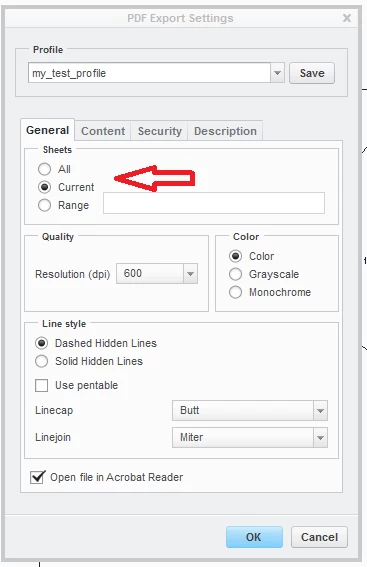

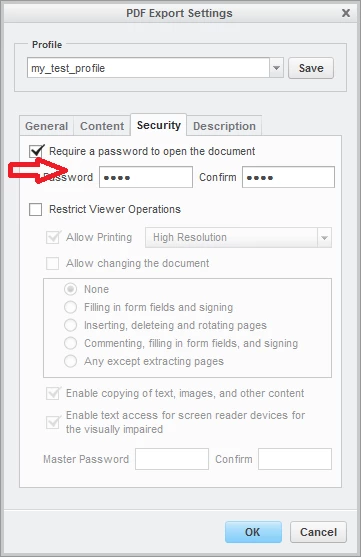

But I can't find the XML attributes for the following export settings in my profile file my_test_profile.dop (see below):
a) General --> Sheets --> All||Current||Range (see PDF Export Settings in pdf_export_settings_general.png)
b) Security --> Password/Confirm (see PDF Export Settings in pdf_export_settings_security.png)
Where can I find these settings?

February 7, 2018
I created a drawing with 3 sheets and set Range 1-2 in dialog box.
.dop file contains following lines:
<SHEETS SOAP-ENC:Array="[2]">
<entry>1</entry>
<entry>2</entry>
</SHEETS>
To understand sheet management, you have to experiment little bit ...
In case of password, I do not expect that this information can be set in .dop file ...
