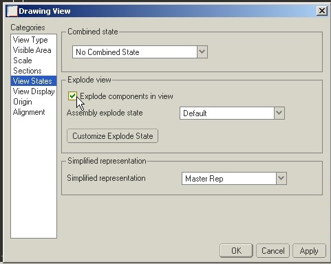

I was able to make the simplified rep again. However when I go to the drawing and create a view it doesn't let me select a simplified rep.
It is grayed out and set to "Master".
Is there a setting I am missing .

This is Creo 3; this dialog is the same as I remember.  As other confirmed, it all depends on what model is loaded and active.
This dialog pops up on a couple of different occasions.  Below is the "add model" dialog response.

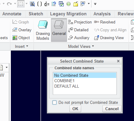

I just noticed that if you use combined states, it also adds and activates the model automatically.
In the part model:
Each time you create a general view, you are prompted for a combined state.
If the simplified rep is not already loaded, it will be when you create the view.
Also note that it becomes the active model.

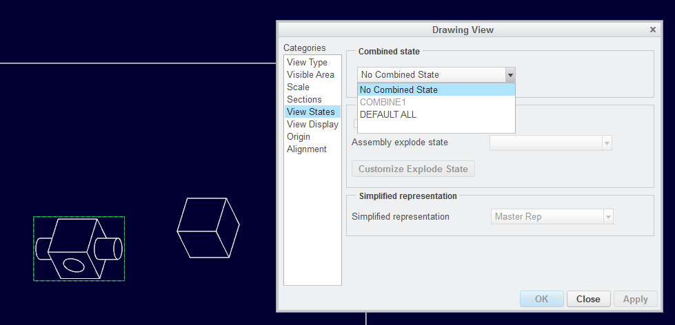

The dialog that appears to not cooperate is the view properties "edit" dialog.
These have always been limited, and in some cases logically so.

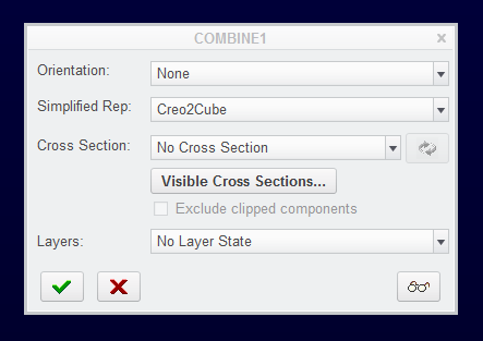

The cube on the left is the master; the one on the right is a simplified rep that removes two features.
COMBINE1 was created to use the simplified rep.  The simplified rep dialog in the UI below doesn't allow editing (Creo 2).

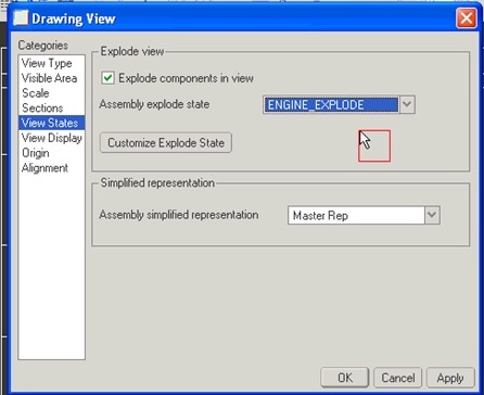

For parts you need to have the simplified rep you want for a view active before making the view. This goes back to early Wildfire releases or prior Pro/Engineer releases when the description was labeled Assembly Simplified Rep. Ever since Assembly was removed from the description it has caused a lot of confusion. The option was originally intended to change between Assembly Simplified Reps, the help documentation points this out. I'm not sure if PTC was working to allow this option to also switch between part simplified reps, at least I haven't seen anything that says they were. The Creo 2 Detail Drawings documentation still shows that Simplified Representation in the Drawing View>View States is used for assembly views not part views. Based on what you describe I'd say the functionality hasn't changed.

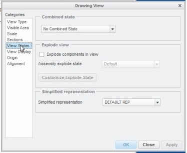

‌Another work around that has been used is to add the part by itself to an assembly model and create assembly simplified reps with the part reps.
I was able to determine that WF3 was when the change was made.
WF2
WF3
CREO 2, CREO 3
