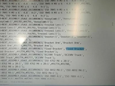

open STEP in Notepad. Can you find original names in the file?

Hi Martin, yes the step file has names in it.

If that text hightlighted is what the part name is supposed to be, then you have a problem, because that's not a valid file name for Creo. You can't have spaces in file names in Creo.
From the support page about files:
"You cannot use brackets, such as [ ], { }, or ( ), spaces and punctuation marks (.?!;) in file names."
So, the importer probably sees these file names and assigns them new names during the import to comply with these restrictions.
