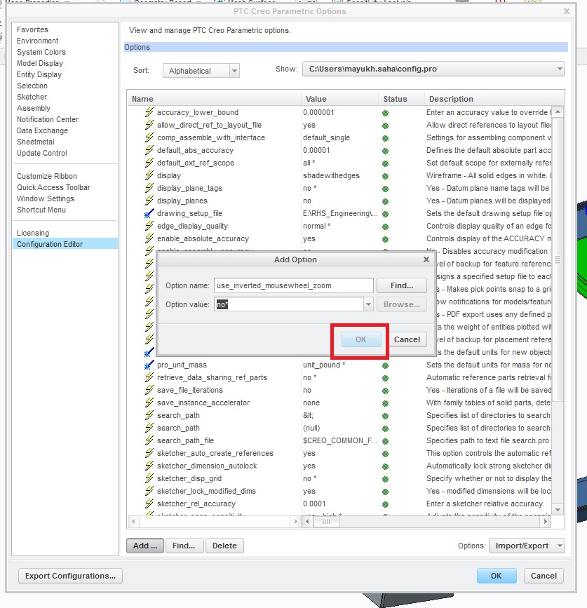

February 3, 2017
Hi Martin,
I have got a config.pro file and i am using creo 3 but that use_inverted_mousewheel_zoom option is not appearing in the config file. neither i am able to add that in the config file.
msaha1-VisitorAuthor
February 3, 2017
@amit deshpande - i am using creo 3. normally if you scroll the the mouse wheel forward (moving your finger forward on the wheel), it zooms out and zoom in for reverse. i want to reverse that because it has become my habit as i have been using other softwares too.
@shane villafuerte - use_inverted_mousewheel_zoom is not appearing in my configuration editor. neither i am able to add that in the config.pro.
I have tried a lot and searched in internet too. yet to resolve my problem.

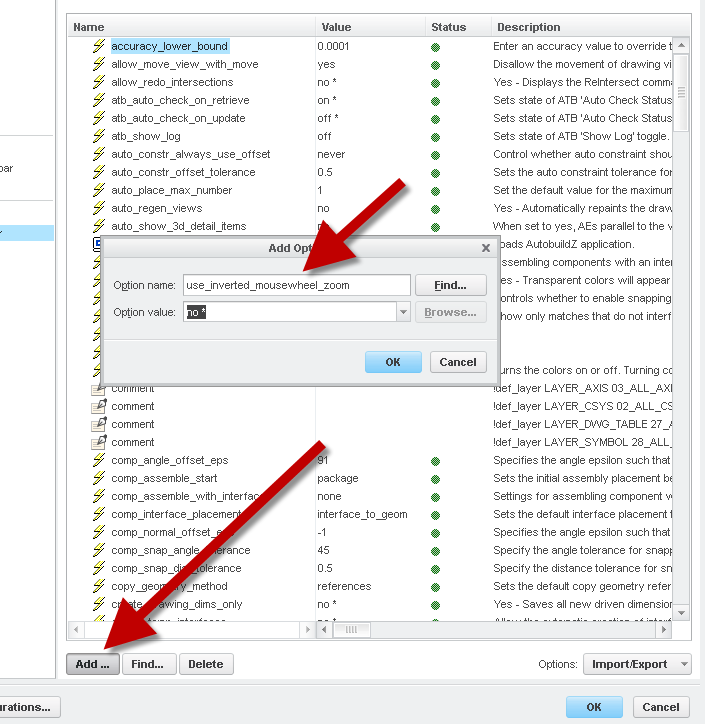

StephenW
February 3, 2017
I didn't try the option to see if it works the way you want but it's there.
Use the add button, default is NO, change the value to YES.
February 3, 2017
As you can see i have tried that but the "ok" option could not be accessed. hence it is not being able to add.

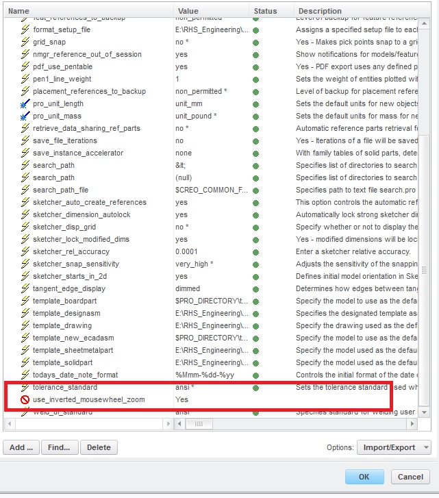

February 4, 2017
Stephen,
I tried that too. But the solution is not obtained yet. you can see the picture below.
StephenW
February 6, 2017
The circle with a slash through it means it's an invalid option. Not sure why that is.

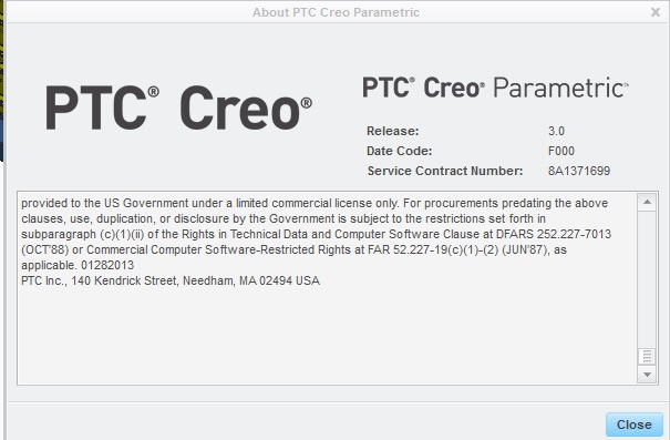

What release and build code are you using? You can find that under FILE - HELP - ABOUT CREO PARAMETRIC.
February 6, 2017
Yes, its shows the following
February 18, 2017
Hi Stephen,
I am already using Creo 3.0. This means that I should be having the option I suppose.
StephenW
February 21, 2017
You are on Creo 3.0 but your build code is F000, that means you have the first release of the software. As Matthew stated, the option was added in build code M010, which is a maintenance release of Creo 3 (software update). You will need to update your software to be able to use the option.
