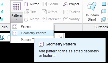

Use the seed surface and boundary tool to copy/paste all of the surfaces. You can then pattern the resulting copied surface feature without any merge. Create a solidify cut and reference pattern that cut. (Can be accomplished with protrusions also) In Creo Elements/Pro 5.0 and Creo 1.0 this is now all inclusive in the Geometry Pattern command.

If you are using Creo the geometry pattern should be much faster.

You can also do a pattern of a pattern with geometry patterns.
