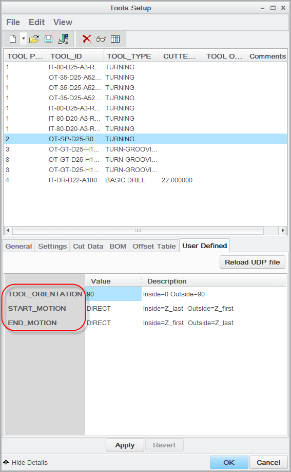

  2. As we know the tool parameter (cut data) can be stored on “work center”, and those data can automatically copy to parameter window. This function is very useful for NC users. If PTC is willing to add “TOOL_ORIENTATION, START_MOTION and END_MOTION on “tool setup” dialog window, as shown below illustration. Currently, after tool selection, users need to set up parameters which are mentioned in previous every time when they create sequence.  (Work center可以存儲刀具這個功能真的很棒,如果可以再把Tool_Orientation(定向)Start_motion and End_motion都可以在選擇刀具時去做定義,那使用者就不需要在每次製作Sequence時最重複的動作。)

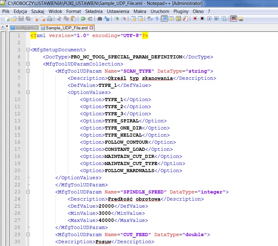

Ad. 2 You can do that:
1. Create UDP.xml file with your parameters (TOOL_ORIENTATION, START_MOTION and END_MOTION)
2. set config.pro option : mfg_custom_tool_param_file   <load_file_path>UDP.xml for example d:/ptc/setup/udp.xml

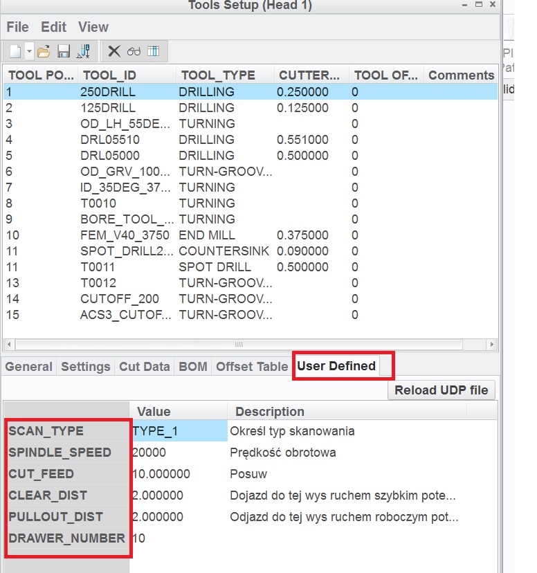

3. restart Creo. Your Tool Setup Dialog Box look now something like this.
4. Now if you copy parameters from tool you copy all parameters.

Hello Tomasz,
Thanks a lot for your help.
I have follow your procedure to set up Creo and created .XML file but I got failed information when I restart Creo, Do you know what?
Could you please provide .XML file to me for reference?
My e-mail= -

July 19, 2015
Hello Tomasz,

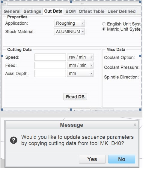

Thanks for your sharing and I can seem the "User Defined" dialog of Tools Setup window. But I still have question about parameters copy, could you please let me know how to set up config.pro then "Cut data" parameters can automatically copy to sequence parameters window?
I have set up "mfg_param_auto_copy_from_tool" of config.pro for "ALL", but that "cut data" parameters still can't copy to sequence parameters window.
Thanks so much
Have a good day!!
Mark Rao
July 20, 2015
Reffering to your question:
If you set any value in  CUTTING DATA box it works well. I don’t know why doesn’t work if here is empty.

July 19, 2015
Hello Tomasz,
I could copied parameters to sequence from tool cut data and user defined, because I forgot store user defined parameters in each tool. My question was resolved, thanks a lot for your answer. Thanks again.

July 20, 2015
Hello Tomasz,
This problem was fixed out, because I forgot click "Apply", sorry!!
thanks for your support!!
