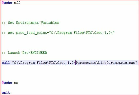

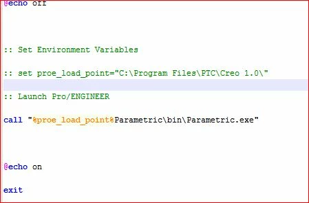

I have attached 2 screens shots of launch script,
see the difference and say why the script was not call pro-e when i save the file like picture 1, in picture 2 was working good.

One of two reasons:
1: you for got to remove the comment in front of the "set" statement
or 2:
Because you have the variable inside the quotation marks. It is simply ignoring it as a variable.
try:
set proe_load_point="C:\Program File\Creo 1.0\"
call %proe_load_point%parametric\bin\parametric.exe
You might remove the echo statements so you can see what is going on.
