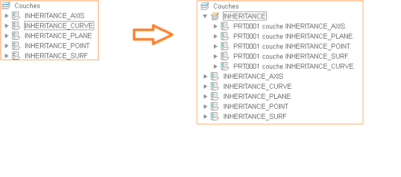

Hello everybody,
I would like to create layers within layers by rules in order to finish a template.
The problem is that I can't find the right search for creating the rules...
As "Layers" is not part of the standard research , do you have any idea to solve it?

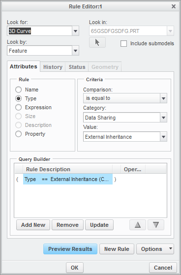

For example I would like to  add with a rule different inheritance layers to the main layer named "inheritance"2016-05-09_09h23_112.png
May 9, 2016
Romain,
See attached snapshot and try.
