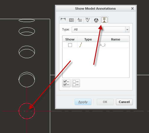

New to the PTC community, and looking for an answer about hole call-outs on drawings.  I have a sold model with UNC threaded holes on it, and when create a drawing I can get the callouts to show up, but the leader line is not attached to the bolt hole in the standard drawing format which is used by other drafting programs.  (Where the leader has and arrow pointing toward center of circle, but touching outside of circle).  Instead I get an arrow that is inside the bolt hole.  Is there any way to change this so I get arrows/leaders which follow the standard for detail drawings?   Also, how do I add cross hairs and center points for bolt holes to the drawing.  I'm using Creo 2.0, and have searched through my books and resources, and scoured through the program itself, but have been unable to find anything.

For the centerlines on the bolt holes, go to the annotate tab, show model annotations, select the datum tab and select the hole (or view) you want to show the centerline for.
Not sure what you are saying about the hole callout...maybe a screenshot would help

Thank you Stephen.  Your method worked for adding the crosshairs, but I'm still having the leader issue.  Here's what my leader attachment looks like for a hole:

Ok - I found how to change the leader attachment:
Click on the leader to select it.
Go to:  Annotate Tab --->  Attachment --->  On Surface
Then select the point on the outer edge of the hole to attach the leader.
I had tried this before, but was missing the last step.  Surely there must be a way to have them attach in this fashion by default, rather than having to change it every time?
