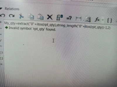

Feb 6, 2025 7:25 AM UTC
Hi ,
After input the relation i got "Invalid symbol"error. Did I missed something?

Feb 6, 2025 12:40 PM UTC
You need to change the parameter in your table from rpt_qty to My_qty.
Yours should be:
&rpt.rel.My_qty
This is in my table:
&rpt.rel.newqty
This is in my relation:
IF asm_mbr_pn == "9594"
NEWQTY = "0.5"
ELSE
NEWQTY = rpt_qty
ENDIF
