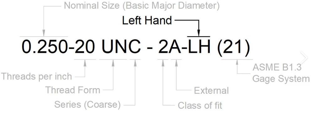

Symbolic representation of RH and LH threads would be the same. In your thread callout, just add LH after the thread type.
If you wanted to automate it a little, create a new hole file for the left-hand threads and modify the automated calout information to indicate LH.

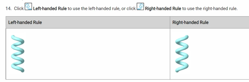

Nov 1, 2022 7:27 PM UTC
When using a helical sweep feature there is an option for left/right hand rule.

Nov 1, 2022 7:40 PM UTC
It is typically dealt with in the hole callout/note with the suffix "LH". This is a US standard example; it may be different for ISO/EU standards.
