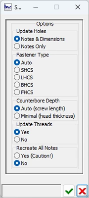

I ended up doing three things:
  1. Remove all obsolete hole files from the end user's Creo configuration.  They only get the new hole files.
  2. Leave all obsolete hole files in the CAD worker's Creo configuration (along with the new hole files.)  That way nothing ever gets messed up during publishing if a hole feature is still depending on the old hole tables.
  3. Built a SmartAssembly program that interrogates each hole feature to determine what it used to be, figure out what the replacement should be, and then update each hole feature to use the new hole table.  This also allows us to do some things that can't currently done with the out-of-the-box hole tables.  Things like setting counterbore depths based on actual screw lengths and setting thread depths based on a company standard.
