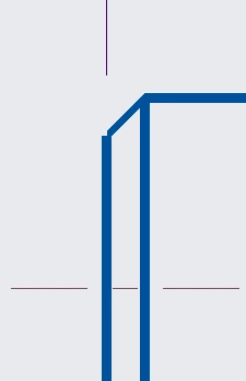

have a look at the following picture:
As you can see, the beginning of the measurement-line is not where i want it to be.

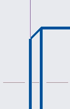

For me, it should look like this:
Is there a way to fix that?

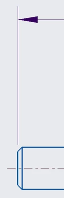

1.] shown feature dimensions
Distance between feature geometry and shown dimension witness line can be set using following detail option
witness_line_offset 0
Test:
Create cylinder geometry + appropriate drawing view + show cylinder dimension.
>>> witness lines are attached to cylinder geometry ... OK
Add chamfer to the cylinder
>>> in drawing view you can see a gap between witness line and model geometry
       (because witness line is still attached to removed cylinder geometry)
2.] drawing dimensions
Distance between selected geometry and witness lines of dimension created in a drawing can be set using following detail option
Test: If you create drawing dimension and select appropriate references then you will get requested result.
