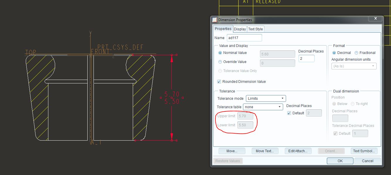

Hi
I am having problems with limit dimensions I wish to be able to set upper and lower limits in the dimension but the option to allow me to edit this is greyed out.
I have taken the time to read a few posts so I know about changing
tol-display to yes in drawing options
I have also changed
Tools > options > tolerance_standard to ISO
I am just a bit lost where to go from here.
Thx.
Capture.JPGHope you can help.
Jul 1, 2013 1:01 PM UTC
I think that it is because it is an 'added' or 'driven' dimension, you should be able to enter the limts required in plus-minus mode and it will display correctly when you go to nominal.
If you use a 'shown' or 'driving' dimension you will be able to enter the limit tolerances directly.
If you are using limit tolerances you might also want to visit the config.pro option maintain_limit_tol_nominal - the default is no

Jul 1, 2013 1:07 PM UTC
I think it comes from:
A) TOLERANCES_TABLE_DIR config options OR if you didn´t specify check
B) start parts
Check FILE - PREPARE - MODEL PROPERTIES - TOLERANCES (click on change) - popup menu apears - click TOL TABLES - MODIFY VALUE - GENERAL DIMMENSIONS
Here you can see and set table with generall tolerances (tolerances for unteleranted dimmensions), for shaft and holes...
In drawing mode try different TOLERANCES MODE (switch limits to plus/minus) - TOLERANCES TABLE = none, than you can write your own tolerance.

Jul 1, 2013 1:29 PM UTC
Hi Charlotte
Thx for you help it works with dims generated from Show model annotations but not with dim's added myself odd but this should allow me to complete my work Thx.
Last time I had a work mate who set this up for me I don't remember what he did last time, I was able to manual add a dim then change to limits then adjust the values I required.

Aug 14, 2017 5:14 PM UTC
Edit is using the "plus/minus" option, then switch it back to "limits".
It should display correctly.
IE:
Dim in CAD is 0.4, you need a limit of 0.394-0.400
Edit plus/minus +0.00, -0.006, switch back to limits.
