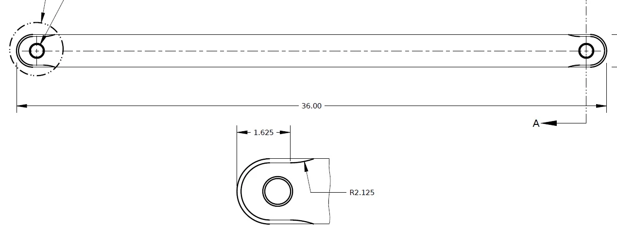

When I export a drawing to PDF every radius is bold while the straight lines are standard. I want everything to look the same. I attached an image below to show what I mean. Anybody know the setting to change in order to fix this?

Hello Christian
Do you need set configuration options:
pen_table_file path to pentable file (tested pentable file - see attachment)
pdf_use_pentable yes
use_8_plotter_pens yes
Note: Try it and I think you'll be satisfied with the results
Vladimir

May 5, 2011 7:33 PM UTC
Very nice. I reduced the thickness of pen 1 but other than that everything was perfect.
Thank you for taking the time to do that.
