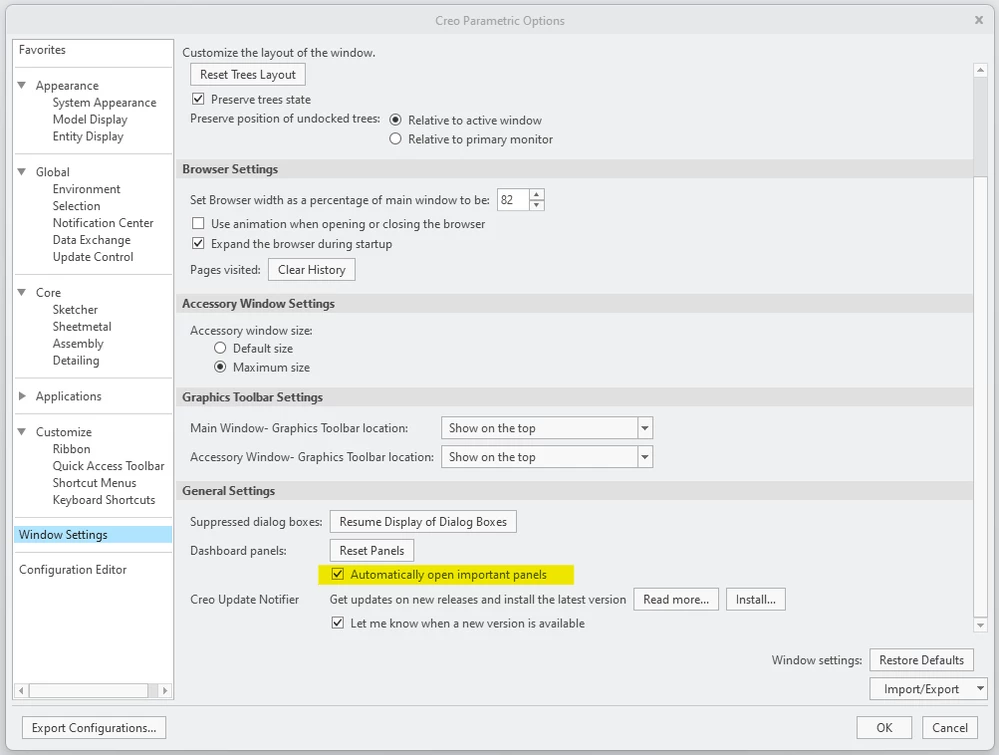

I'm not sure what you're referring to when you say all the dialog boxes are open..?
TomU
Dec 21, 2022 8:07 PM UTC
@bbrejcha,
Uncheck 'Automatically open important panels' under 'Window Settings'.
