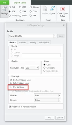

Summary of the exchanges and list of solutions:
  • If no Pen Table is used, the line weights will be set "as displayed" on the screen in the PDF.
    • pen#_line_weight configuration options won’t affect the export (only plotters)
  • In order to control the line thickness, you will need to use a Pen Table as explained in article CS25880, also some examples are provided in the different replies.
    • Then each line with a given System/Entity color (eg Geometry, Curve, etc) will get the properties defined in the corresponding pen.
    • User-defined colors will go to pen 1
    • The thickness defined on screen will be preserved if not explicitly defined on the pen, otherwise it will be overridden.
      • Therefore you cannot specify a new default thickness for objects assigned to the same pen and keep the manually entered weight in drawing for some of those lines.
      • Possible workaround:
        • Set lines with a defined weight to a different system/entity color that is assigned to a pen with no thickness argument.
        • If you need to specify a user defined color to those lines you may want to move the other system/entity colors (eg Geometry "drawing_color", Datum "datum_color", etc) that go to pen 1 to another pen (eg 4), and keep pen 1 for user defined color only.
        • For example only setting a black color as output:
pen 1 color 0.0 0.0 0.0
pen 4 thickness .035 cm; color 0.0 0.0 0.0; drawing_color; datum_color

Thanks Brent. I'm attempting to do the same thing you did - trying to improve our formats and templates. Not sure what is "pdfpentable". Perhaps this is the config.pro setting I should be using, but I can't seem to locate it in the config editor.
The option"pdf_use_pentable" for pen 1 will change ALL lines including my drawing border meaning that geo lines will be very thick (like the border) or the border will be very thin (like the geometry lines). In other words, using a pen table will overwrite my user-defined line thicknesses.

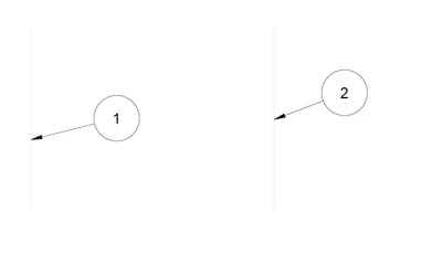

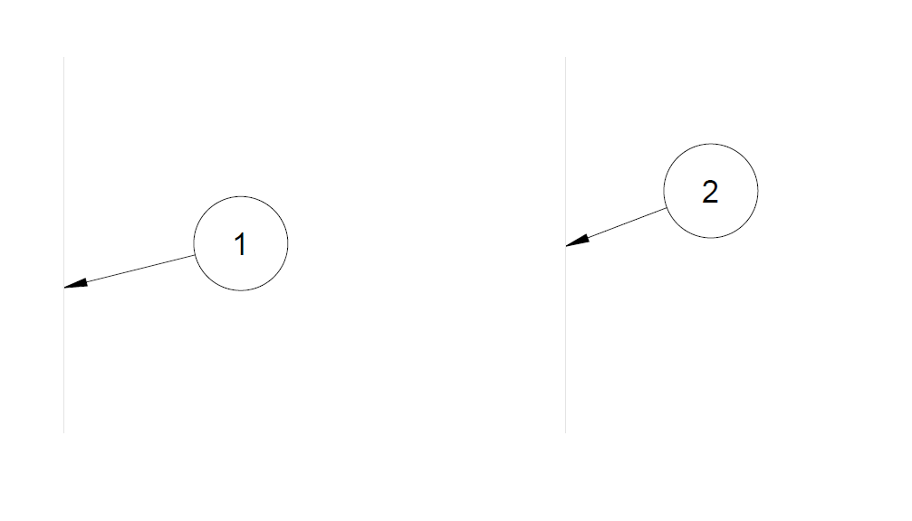

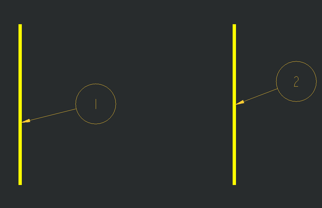

hey guys, I have a similar if not same issue, I just want to confirm that before I go changing everything.
I have a drawing of a dxf file, I change the line style width to 1.000 from 0.000, the line gets wider in the drawing and its what I want but when I print the dxf its really thin just like the rest of the lines.
below is what I want and then what I get after creating a pdf.
thanks in advance
Carlos
thanks in advance
Carlos
