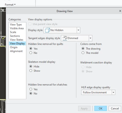

The magenta lines are surfaces that didn't convert to solid during your import. Sometimes you can fix those, but with those threaded areas, it may be a lot of trouble.
You can turn on hidden line removal in your drawing for HLR using the config.pro option hlr_for_quilts yes
Check your drawing view properties, it should show hidden line removal for quilts is set to yes

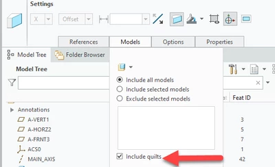

If your view is a cross section view, you will also need to edit your cross section to "include quilts".
