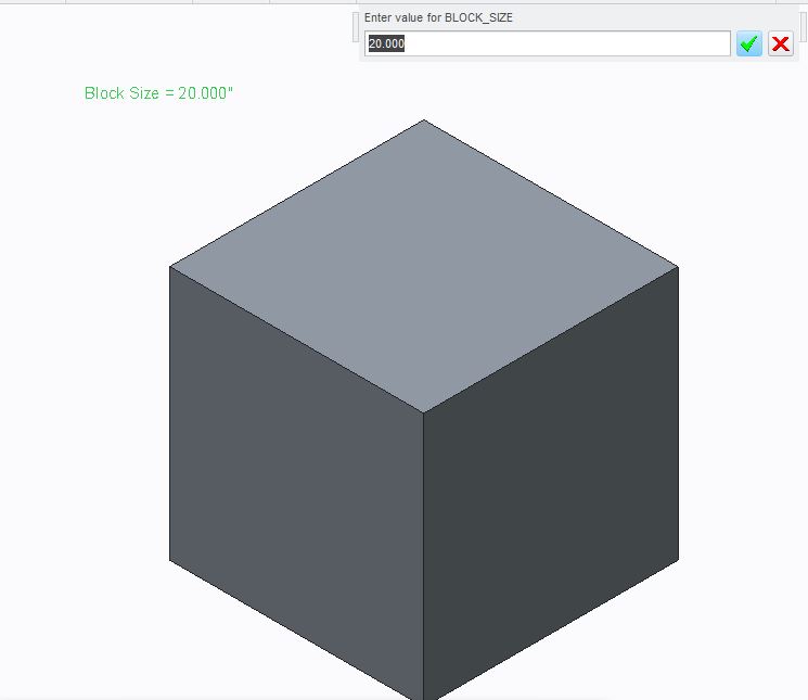

I wonder if I already know the best way to accomplish this...  Here is what I am looking for:
I have an assembly with a handful of the same instance assembled individually (no pattern)
They all share the same value for an offset dimension - the offset is from another instance.  I want to manipulate one dimension and have all the others follow.
I could create a parameter and relate all the dims to that param.  But then I need to go into parameters to edit the value.
I could relate all of the dims to one instance - but then I have to remember which one needs to be edited for the change to work...
I'd really like to be able to edit any of the dims and they would all update.  Is that possible?
Thanks!
-Nate
Feb 3, 2016 10:56 PM UTC

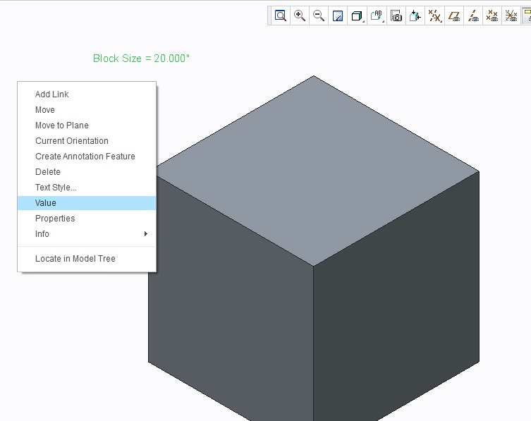

You could use your parameter method, but rather than going into parameters to edit, you could place a reported note on the screen and edit the value directly from the note.  Once you feel like you don't need the flexibility anymore you could delete the note.  In my example below I have created a "block_size" dim and in relations equated that to the 2 dims.  I can then edit the parameter directly from the note.

To change only one offset value and have all change without having to worry about a controlling instance your going to have to use a parameter and relations. Another solution to not having to go into the parameters dialog is to add the control parameter to the model tree.
