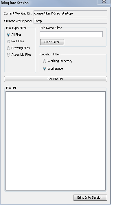

We did this using JLink. It brings selected files into session (memory).
James621-VisitorAuthor
September 1, 2014
Nice GUI. I'd like to be able to bring in a bunch of *.drw files, but the other filetypes might be usefull as well.
Thanks for the idea.
