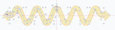

We recently installed 7.0.8.0 and I am having some difficulty in constraining a sketch.
I want to keep the squiggle below at a constant thickness.  As I constrain the center points of the inner arcs to the outer arcs, some of the coincident constraints that I just created disappear.  When I recreate them, others will disappear.  Anyone else experiencing this this issue or have an idea of what is going on?

I have been able to complete the sketch.  The problem was most likely that I was attempting to over constrain the sketch.  I started with making the arcs equal and the lines parallel, then i started making the arcs coincident.  The solver did not like the added coincident constraints and deleted them as I added more.
The real issue here is that Resolve Sketch dialog did not pop up to show me the constraints in conflict so that I could choose one to delete.  Which brings up another issue with Resolve Sketch.  Many times it does not show all of the constraints that are creating the conflict and I end up selecting Undo, deleting the unwanted constraint, and recreating the constraint I was trying to create.

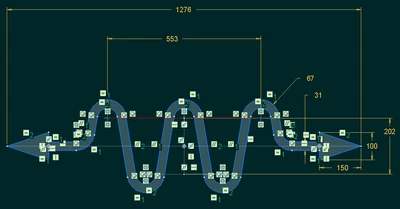

Maybe one squiggle too many?
Not seeing your issue here in a Creo 4 sketch, but it took me quite a bit of "wrangling" to get to this state:

There are situations where the sketcher intent manager is not able to apply the intended constraints. To fix this I have found that adding construction geometry or simplifying the sketch will resolve the issue. In Creo 7.07.0, I was able to mimic your geometry broken down into two sketches and it seems to behave.

One that bugs my OCD is that it accepts certain "over constraints"  For example, if you have a horizontal centerline and a horizontal line segment, and then you create a coincident constraint between the two entities, it will accept a sketch that has 3 constraints instead of only 2 that are necessary.
(Yet if you have a horizontal line and try to constrain its endpoints to be horizontal, it will complain)
Another one that I realized as I was working out your squiggle example, is that if you place a point on a line, and then make it a midpoint, the system keeps both constraints - but only the midpoint constraint is necessary...
I wish it would flag these "over constraints" and force user to resolve them so as reduce the clutter.
