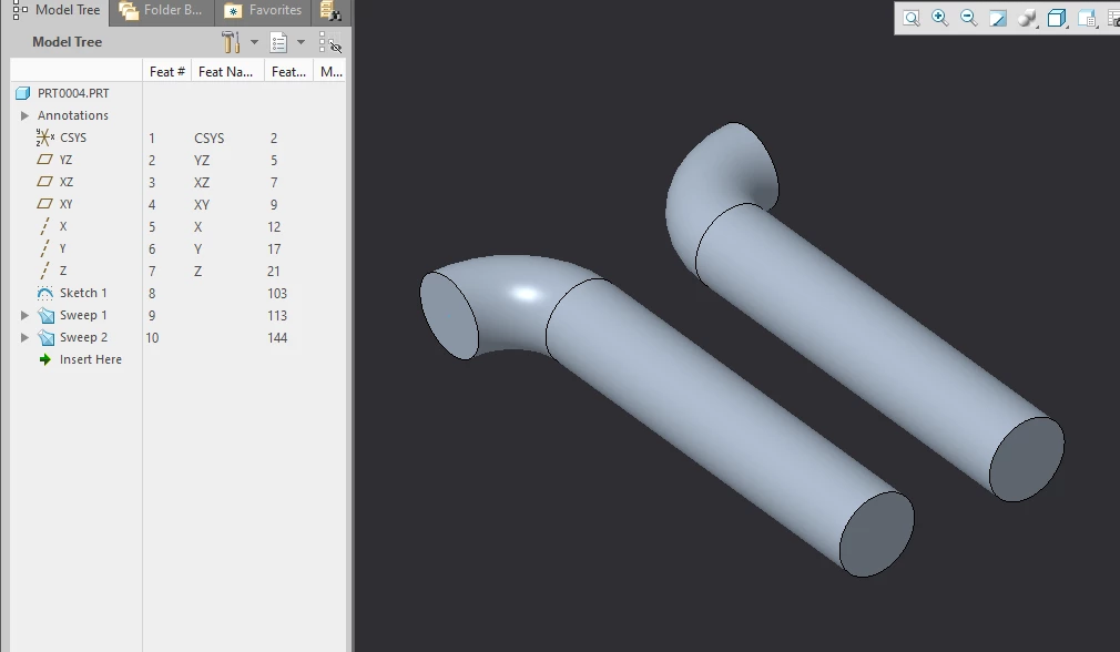

Thank you for feedback, but I think I described my problem insufficiently.
I made simple example shown in attached screenshot.
Both sweep sections are circles. I would like to have main sweep section (sketch), every time when I will edit this 'main sweep section' both sweeps (sweep section) in tree will be updated automatically.
In example it is easy because we have only one dimension (diameter) which can be depended by parameter value and only two sweeps. In more complex model and cross sections parametrizing every dimension is not effective.
kdirth
September 14, 2021
If every sweep trajectory is parallel at some point, you could create a master sketch, create the section at that parallel point and project the master curves into the section.  Probably not that simple of a problem.
Have you tried creating parameters of the main section dimensions and create relations in the sketch to drive the relationship?
tbraxton
September 14, 2021
Your description is open to interpretation. Are you asking if you can use one sketch to define the trajectory of all sweeps or use one sketch to define the section of all sweeps? The answer to either of these is maybe, it depends on the geometry you need in the design.
A more detailed description of your goal would be helpful.
