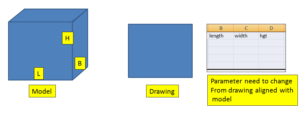

I would like to know, Is it possible to make 3D model parametric by using drawing . For example, I have created box having 50 X 50 X 50 mm ( L B H) respectively and have drawing for it as below mentioned. So every time instead of changing CAD model parameter , I will change directly value on drawing table which will changes drawing and model accordingly.
Please let me know if someone have any idea about this. Thanks in advance.

Look for 'switch dimensions' to see the parameter names that control the dimensions.
Then, on the drawing, create a note using the parameter name prefixed with "&" as in &d1. If you edit the value of the note parameter then that will change the model. You can, if you like, use that same note inside a table cell.
February 22, 2017
Just as he said, with one elaboration -- you had said 'parameter', but it isn't clear if the value you want to change is a parameter or a dimension value.  Either can be modified from the drawing, the mechanism noted above is for dimensions.  For parameters (say, if you have params BOX_LEN, BOX_WIDTH, BOX_HEIGHT in the solid, and relations 'd1 = BOX_LEN' etc., then you do the same thing but with &BOX_LEN in place of &d1.
2-Explorer
February 22, 2017
I prefer the more general definition of parametric where the dimensions are parameters, the key part of Parametric Tech. They can also have their names changed to be more readable, just like unrelated parameters.
