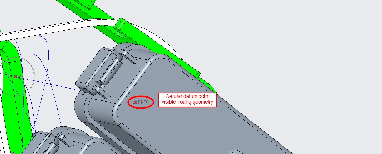

When there is geometry in front of a location point, you can't see it as it is 'hidden' behind the geometry.
However, I would like to be able to see them just like you can always see datum points, no matter if they are behind / within other geometry. In that way, it's easier to spot & select them without rotating the model or go into 'edit segment'.
Maybe even make it a quick toggle; 'show location points trough geometry' - Yes / No
For example:

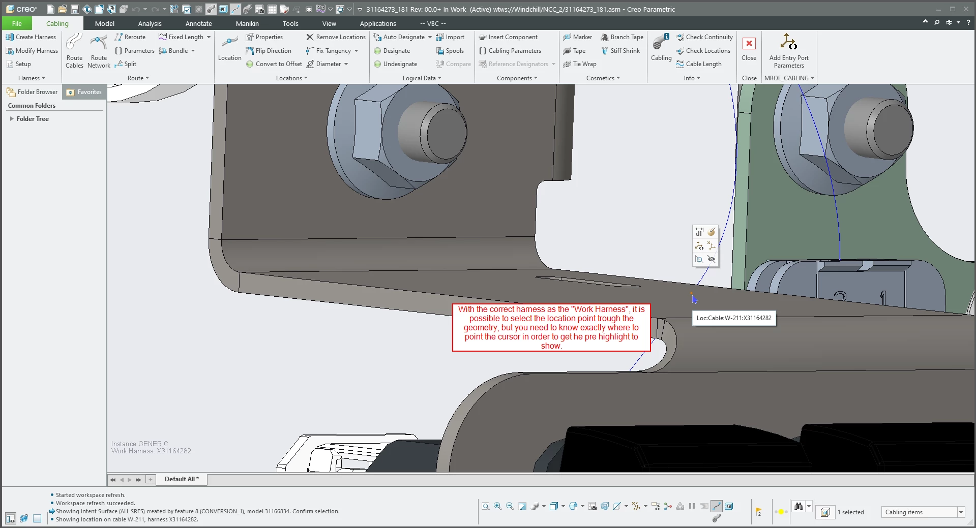

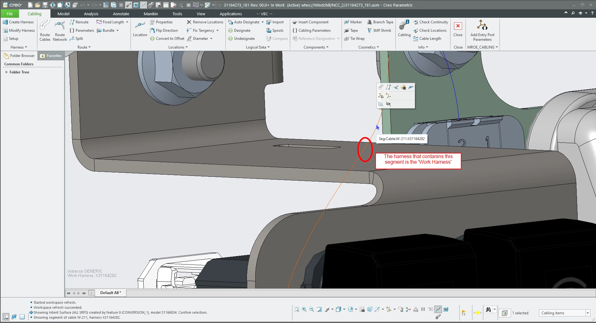

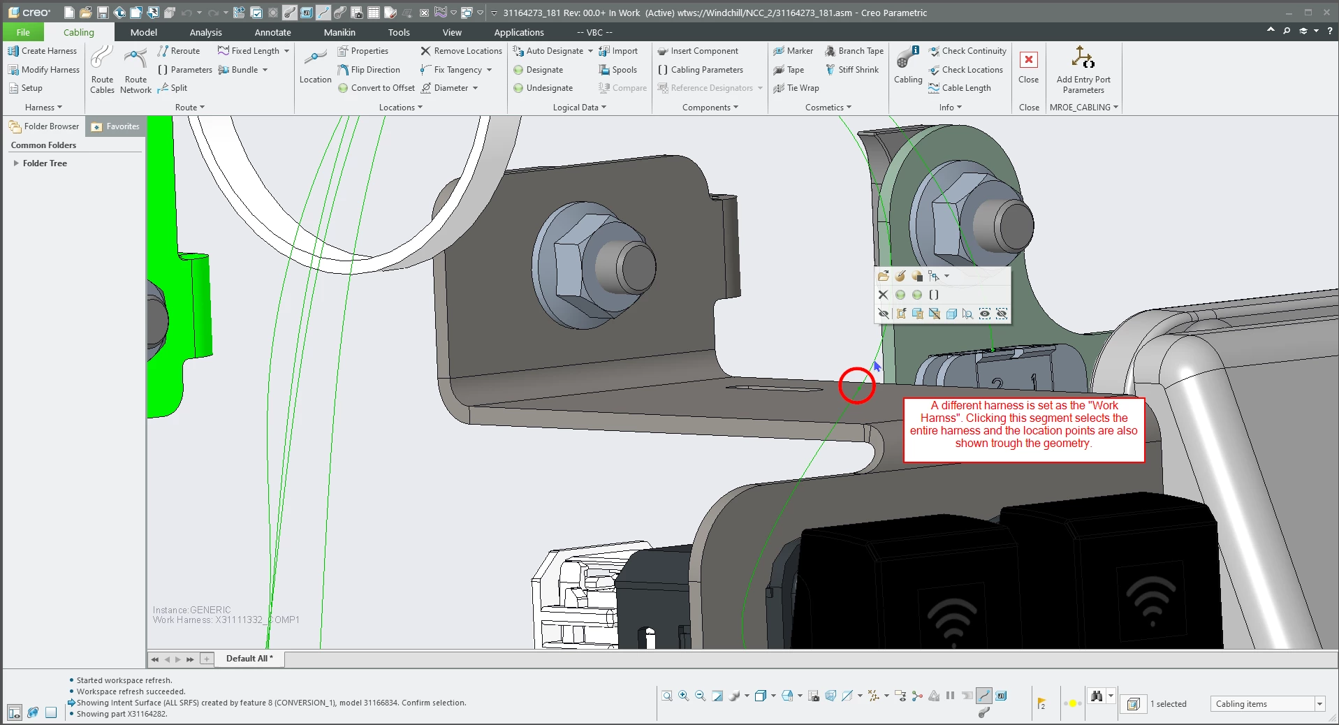

What I also noticed:
The harness with the location point I needed to edit is in assembly that also containts other harness assemblies. When another harness (or none) is selected as the working harness, and you select the segment of the harness that has a location point behind geometry, the location point is also highlighted. But if I select the that harness as the work harness and select the segment again, the location point is NOT higlighted.
