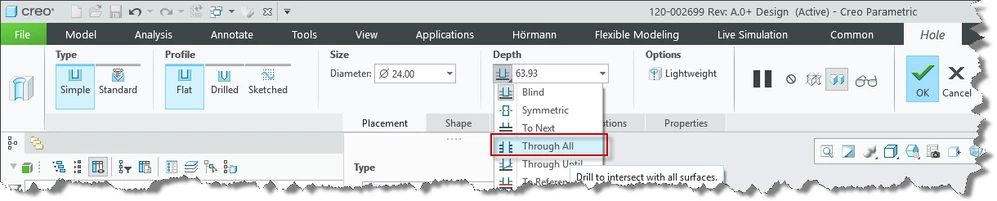

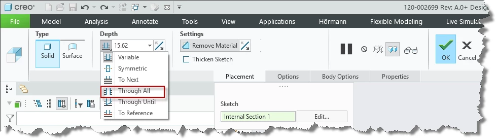

As at least until Creo Parametric 11.0.6.0 when making a cut while using extrude or hole (and several other things that cut through geometry) the default is "Blind" and then with some random depth.

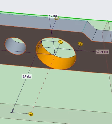

It would be far more confienient when this is "Through all" by default. This also solves that much engineers do not take the effort to set the depth to through all so the end of the cutout is somewhere outside the geometry (as shown below)
So make a config.pro option tho set the default to "Through all" for at least the cases shown below.

Check out feature presets which may address your particular issue if you upgrade to Creo 12.
Feature Presets
As of Creo 12.4, feature presets are supported for:
  • Hole
  • Extrude
  • Revolve
  • Round
  • Chamfer
  • Curve from Equation

Sorry, I thought I was in the "Creo Parametric Ideas" section and as I did not found any related I thought it was new.
But it seems that there is already an Idea posted.

Answers indirect the question but for me the problem is that we recently updated to Creo 11 and therefore do not have this functionality, updating is not that easy in a bigger company.
