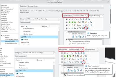

"Make Transparent" command and Geometry Filter
I can't use the command MAKE TRANSPARENT (I don't mean the Transparent command to set the display state) with the Geometry filter. I must obligatorily select Body as filter.
But I can add that command in the mini toolbar in that Selection item...
Is there a way to use Make Transparent with Geometry filter?

In Creo 9.0 I have Geometry filter selected when working on part. When I select Body using Pick From List command the mini-toolbar is displayed containing Make Transparent button.
I use 8.0.7.
If I select Body that command appears also to me, but I wonder if there is the possibility to use the command simply "touching the surface" with the geometry filter activated.
you have to (1) select body, (2) use command. Therefore selecting single body surface is not enough.
