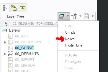

Create a layer and place all your axis features on it.  Do the same for planes.  Make sure you are placing the feature on the layer, not the axis or plane entities.  There is a difference.
Create another layer and place the single axis feature or plane feature that you want to see in it.
Hide the first layer and isolate the second.  Isolate is not in the right click menu, you'll find it in the layer drop down menu.
You should now only see the single axis or plane that you want.
