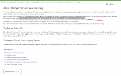

Actually, it is some stated on the website as:
I need two pages of .frm file so that I can call it at the start and I will have multiple pages without need of creating second page afterwards.
