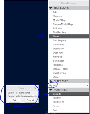

Below I will leave you the solution to your problem.
Table -> Repeat Region --> Filters --> Select BOM --> By Item --> Exclud --> Select the item you want not to appear
And click on Done.

May 5, 2021
And click on Done.
