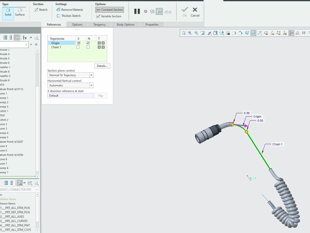

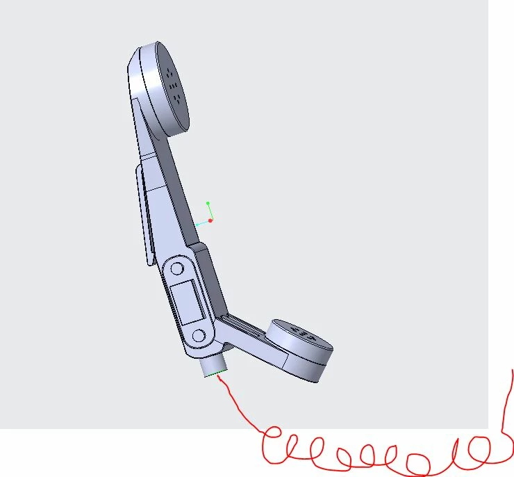

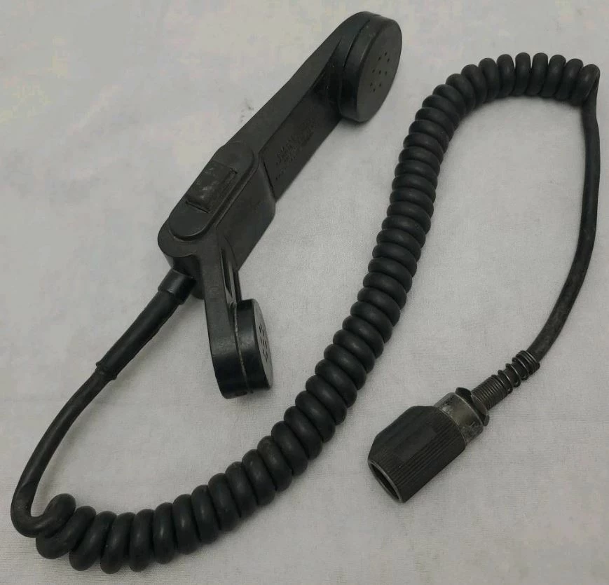

Making of a RADIO cable for TELEPHONE
I know it's a weird Q. I thought worth still asking. Options to build cable, like something as shown in image attached.
THANKS!

Jun 16, 2025 4:01 PM UTC
You have three curves that do not overlap for the sweep tool to follow.  That will not work.  You need to remove Chains 1 & 2 and hold shift to add the other curves to the original.

Yogesh.T
Yogesh.T14-AlexandriteAuthor
Jun 9, 2025 4:16 PM UTC
ATTACH Images.
Yogesh

Yogesh.T
Jun 12, 2025 4:38 PM UTC
Interesting challenges. I am almost there with looking at those challenges and challenging myself... 🙂
MY Question: How to sweep using/selecting multiple curves? It does not take me to sketch mode. (SEE ATTACH IMAGE)
Yogesh
