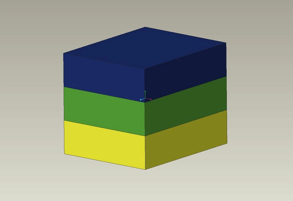

This is an example of how to create the models using 3 "slices". The master and the 3 derivative parts are enclosed for reference (Creo 4 models). This is semi automated with a map key, you can extend this automation to additional steps for each slice as desired such as exporting the STEP files. Using an external script you could write a trail file to fully automate it. You can in theory create a nested map key to automate the whole thing but debugging that may not be worth the time to create it. You can also use one of the Creo APIs to fully automate this as well if it is something that you need to do repeatedly on many models.
Starting from the slice generic part model.
1) save the model as "slice1.prt"
2) run map key "sli"  This map key pauses for user input to select the next slice plane. The current slice plane is highlighted.
3) select the next slice datum in sequence upwards, the map key will execute upon selection
4) Save a copy of the model (i.e. slice2.prt)
Repeat this until all slices are saved as parts. These parts will all assemble by default and maintain their relative positions.
Assembled by default slicesAssembled by default slices
This is a  map key is used to increment the slice cut up from the bottom of the master geometry. Make sure you do not have any map key naming conflicts with "sli".
