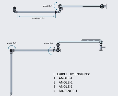

I am working on a large assembly file which contains a sub assembly that is modelled with flexible dimensions. The screen shot of the assembly is as shown below:

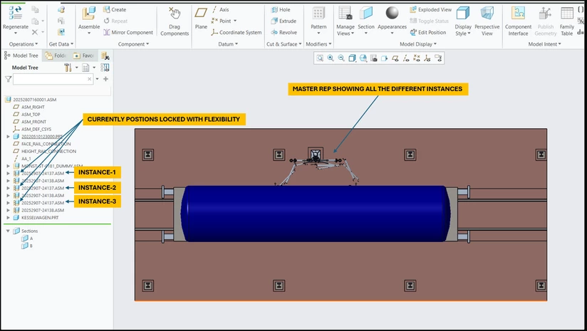

I have made use, of 2 instances of above assembly as a sub assembly in top level assembly and shown them in different configurations as shown below. This was done by modifying the flexible dimensions shown above:
Now the questions are:
Q1:
Is there a better method to manage large assemblies such as this? because every single time the file regenerates, it takes a lot of time.
Q2:
Instead of using flexible dimensions, the other alternative is to make use of mechanisms (which i think is the ideal case) but when the sub assembly is modelled using mechanisms, it becomes difficult to control the varying dimensions (angles and distance) for each instance separately. How do we control this separately?
For example:
Set and lock, Angle-1 to 60° in Instance-1 and 30° in Instance-2
Thanks!

This is just an observation based on your pictures, but I would not classify what you are showing as a large assembly. Perhaps some things are not shown and there are many more components not visible. I am only noting this as this may not be a regeneration speed issue typical of a large assembly.
Can you define what exactly is the meaning of the term "flexible dimensions" in your post. Are you using component flexibility functionality in the subassemblies referenced? You also mention considering the use of mechanism connections, are the subassemblies static or are they designed to move intentionally in the application?
Two things come to mind to minimize the wait on full regeneration at the top-level. Save a copy of each instance needed and set all features to read only. This will remove the flexible components from the regeneration cycle. If you need to flex them, clear the read only setting to enable the flexible functions needed.
Have you considered using a skeleton model(s) to configure the "flexible" components to and thereby giving you the option to placing flexible components in the assembly? With this approach you would be regenerating a skeleton without any bodies, and it should regenerate very quickly. This skeleton would be used to arrange the components of the subassemblies.

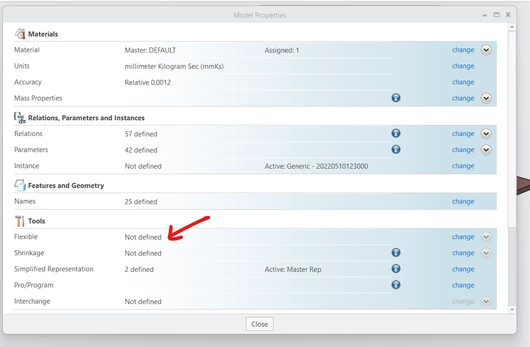

wrt to your question on "flexible dimensions", I am referring to parts/sub-assemblies that are configured with few dimensions as flexible under the prepare section as shown below:

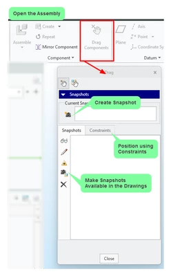

Nov 25, 2025 7:13 AM UTC
From the description, pictures I presume that the flexibility is only for the angles.
If so, then it is not a Flexible Component Design as defined in Creo. This is just a mechanism. At best it is an underconstrained assembly with a single degree of Freedom.
Create "Snapshots" of the positions.
You can retrive the snapshots at a later date and can also have them in the drawings.

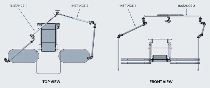

Dec 1, 2025 6:48 AM UTC
Hi Srinivasan,
You are right, this is just a mechanism, and I am aware of the snapshot technique.
This technique works absolutely fine when I have only 1 instance of the Sub-assembly in the Top assembly.
but what I am looking for is a solution, when I need to place more than 1 instance of the same assembly, like shown below.
The concern is, the position of the sub-assembly goes through different iterations between us and our customer until customer is satisfied.
Therefore, it becomes very difficult to work on the sub-assembly multiple times to alter their position and take snapshots.
Also, while making using of mechanism, altering the position of 1st instance tends to change the position of 2nd instance as both the instances are of same sub-assembly loaded in memory.
This is the main reason; I make use of component flexibility to lock the instances in different positions independently.

Continuing the theme of "abusing" Creo functions, another "abuse" that might work is simplified reps. We use this (reluctantly). In your subassembly, you can model each required position by including multiple instances of each part that moves. Then use simplified reps to exclude all the components that aren't needed for the current position. In the next level assembly, you can include multiple instances of the subassembly and control which simplified rep to use for each.
One big caveat for this is BOM management. You'll have to take additional steps to manually reduce the quantity of the duplicated components.
Maybe someone at PTC will see this thread. I don't know of any truly good solution for what should be a pretty simple use case.
