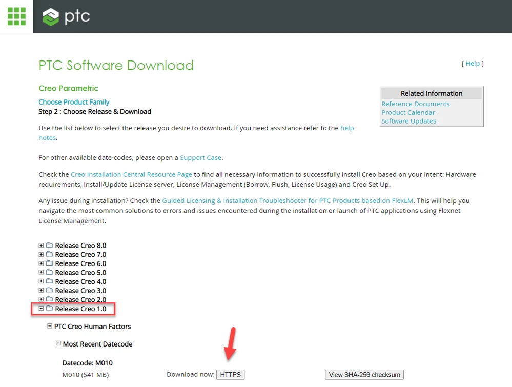

For some reason, PTC has them associated to Creo 1.0 in the PTC software download. You may need to PTC account to download the files.

October 4, 2021
Thanks a lot !!!
So, we just have to copy thoses files anywhere and set correct path "ptc_manikin_library_path" in config.pro ?
Thanks again 🙂
Chris3
October 5, 2021
Yes. If you are using Windchill then you are going to want to use the wtpub:// path and make sure that all of your users are using the same server alias including capitalization.
