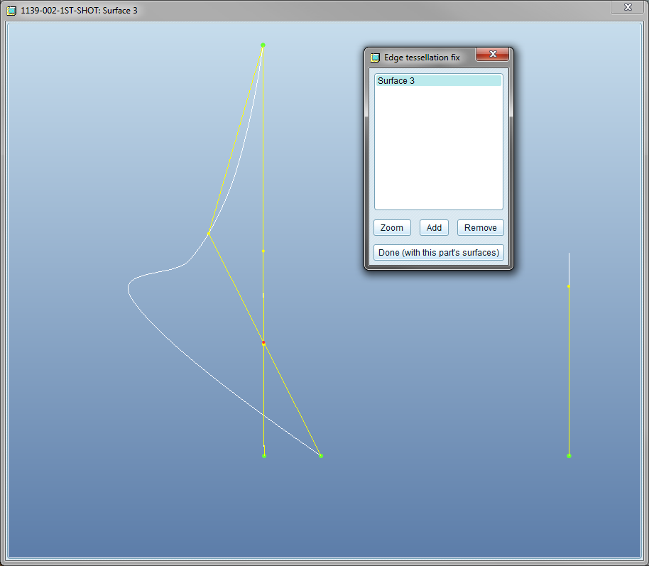

Manual fix for STL export
Does anyone know how to interact with this window?

Dave,
The red point is the problem area - click on it and either add more points around it or delete it.
