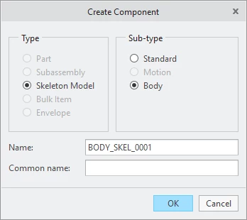

Im trying to add a copied body skeleton in my motion skeleton assembly, this is possible but its placed in the top of the assembly (what happens when you place a skeleton in a normal assembly). I would expect to be able to move the new body skeleton down to the bottom of the modeltree but this is not possible (in Creo 5).
Any help would be appreciated.
Best answer by Tdaugherty
There is a functional difference between standard (design) skeletons and body skeletons. As mentioned, standard skeletons can't be moved to the bottom of the model tree. Body skeletons can when assembled into a motion skeleton assembly. That said, they need to be created as body skeletons and the only way to do that is in the context of the motion skeleton assembly. As far as I know, there is no way to use a standard skeleton as a body skeleton.
You can create a body skeleton as normal and publish/copy from the standard skeleton to the body skeleton. This is what I would probably recommend here. The standard skeleton can be assembled at the top of your motion skel assembly and then you can copy references from it into the body.

Actually Im talking about motion skeleton assemblies, not normal assemblies, so yes body skeletons are placed in the bottom of the modeltree when added, but I cant get this to work when I want to add an already existing skeleton part..
