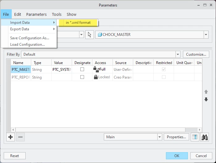

For 10 parameters, import a file. I would import a parameter file using .xml file to add the parameters to the model. You can still use a mapkey but try importing the file and see if that works to overwrite any existing parameters. I have not tested this, YMMV.
