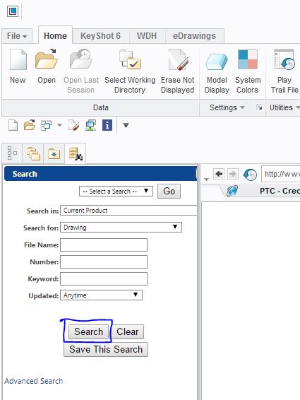

How to mapkey press of this botton?
6 replies
April 3, 2017
I guess that the window belong to custom application. I think you cannot create Creo mapkey representing Search button clicking. Maybe AutoIT will help you.

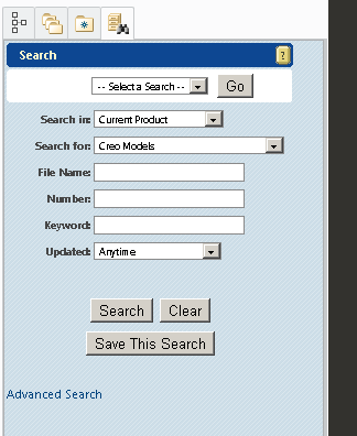

So you are telling me, that you don't have this window?
2-Explorer
April 4, 2017
I've never noticed the window you posted either, but I've only gotten to Creo 3/ WC 10.2.**
In any case, mapkeys are recordings of activities within the Creo parametric modeler and this looks like it is part of Windchill interface, which doesn't have mapkeys.
**With the embedded browser supplied with Windchill I have no idea why there would be an additional window like that. Is there some other PDM/PLM software in use?

This is a Windchill PDMLink commonspace search.
athomasen1-VisitorAuthor
April 4, 2017
Correct. Any method to automize a 'search'?
April 4, 2017
Nope.  This is a mini web browser window.  Mapkeys can't interact with the embedded web browser.
