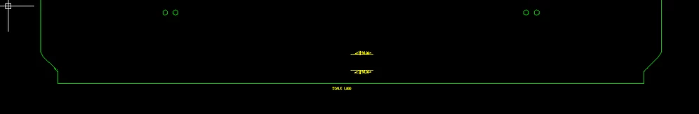

  1. Exported DXF dont have bending lines
  2. Want all SPLINES to be POLYLINES
This is DXF, but it does contains bending lines.

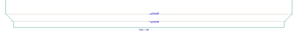

I want DXF to look like this:
Is there any way to export Bend lines by default when creating DXF i know options SHOW annotation and select all lines but i want default way?
