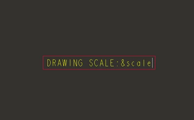

This is one way to generate the mapkey you need.
As a test case for your issue, do the following:
Add a note to the drawing displaying the dwg scale parameter using the exact syntax shown below (&scale).
Test this mapkey which will prompt the user to enter a value for the drawing scale.
mapkey $F7 @MAPKEY_LABELEDIT DWG SCALE;\
mapkey(continued) ~ Timer `UI Desktop` `UI Desktop` `popupMenuRMBTimerCB`;\
mapkey(continued) ~ Close `rmb_popup` `PopupMenu`;\
mapkey(continued) ~ Trail `MiniToolbar` `MiniToolbar` `UIT_TRANSLUCENT` `NEED_TO_CLOSE`;\
mapkey(continued) ~ Command `ProCmdDwgEditValue@PopupMenuGraphicWinStack`;
This video shows it working in Creo 7.09.

Try preselecting the scale parameter before running the mapkey to change the value.
There is a drawing system parameter that sets the drawing scale. This may be a better way to set it rather than mouse picks in the graphics area and UI.
I would suggest creating a mapkey that sets the scale parameter vis user input and nesting this within the mapkey sequence you are attempting to create.
See this link for drawing parameters: System Parameters for Drawings (ptc.com)
