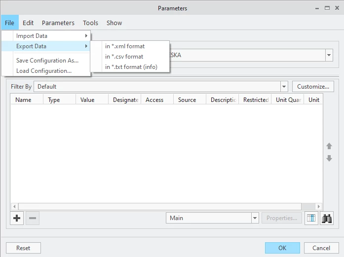

follow below manual procedure:
1.] activate part and export parameters to file ... I hope you can create mapkey to automate this step
2.] activate drawing and export parameters to file ... again Parameters dialog box
3.] build step name using information fetched from saved files (manually -OR- by some programming)
4.] export STEP file
Once the manual process above is working, you can automate it with AutoIt.
