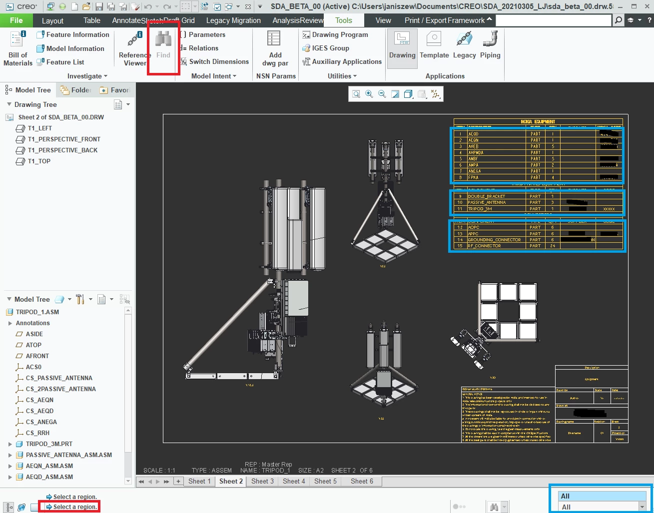

I tried to create mapkeys allow me to automatically creating Ballons from table with 3 repeat regions. I recorded action: (Create Balloons - All -> Select a region) x3 (every time chosing diffrent region of the table). When I run mapkey it's asking me to chose 3 regions then balloons apear. I would like to mapkey automatically chosing those three recorded regions instead of asking me to select a 3 regions all over again. Can I create mapkey which remembers my selection of regions?

Try using the search tool to explicitly select the 3 repeat regions and include that in the mapkey sequence. I would create a nested sequence and break out the search/selection as a separate mapkey that is called by the balloon creation mapkey.
Mar 9, 2021 9:51 AM UTC
I can't use search tools or any mapkey when I create Ballons. I need to select a repeat region by clicking left mouse button. Is there any other way to record those selection? I need to create mapkey which automatically choosing selection of a region in Create Ballons - all action.
Screenshot in attachment.
ask PTC Support. They will tell you whether this functionality is implemented.
