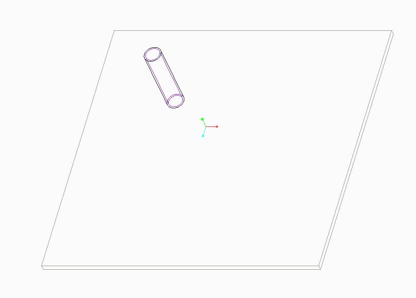

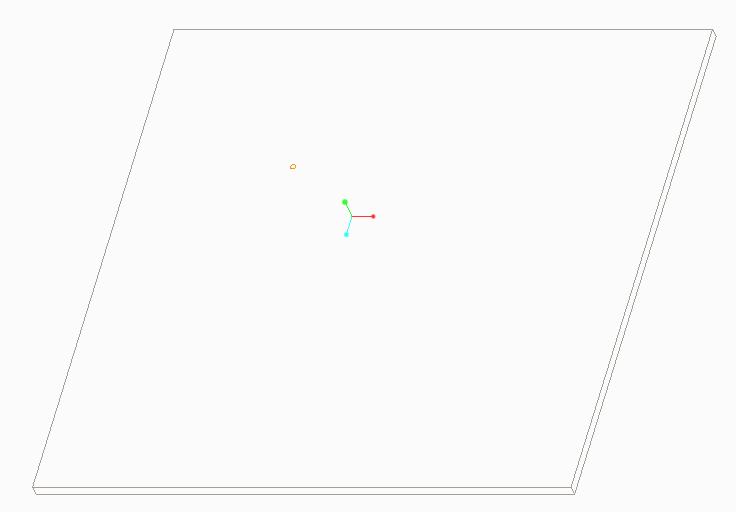

We use marking points on our dxf files on the plate for the position (center) of welding the part.
It is a sketch with a diameter of 1mm on the surface. The machinery recognize this sketch of 1mm and will automatically make a punch mark on this place.
For this we don't need to add dimensions on the drawing for placing the part.
Now we created a subassembly of the part and made the sketch in the subassembly. We made 2 simpl. reps, display drawing (figure 1) and display drawing digital (figure 2). Actually I prefer only a sub part.
For sheet metal it is a problem because the coordinate system I had to place it in the plate. Because it needs to follow the correct position in unbend state.
I prefer to use skeletons for my coordinate systems.
Are there any good ways to do this properly?
