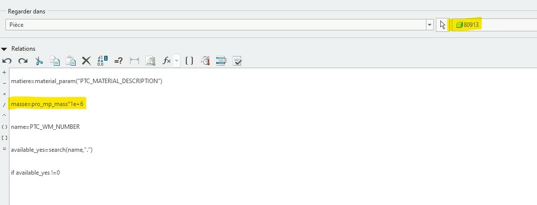

Mass intance on a different sheet drawing
I've a part with an intance (BRUT), and in the same drawing, I want two sheets. One with the final part, this other with intace.

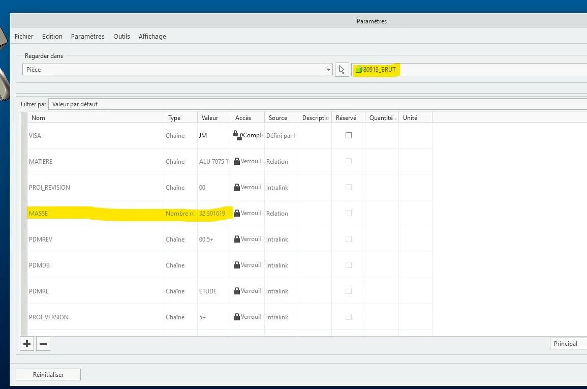

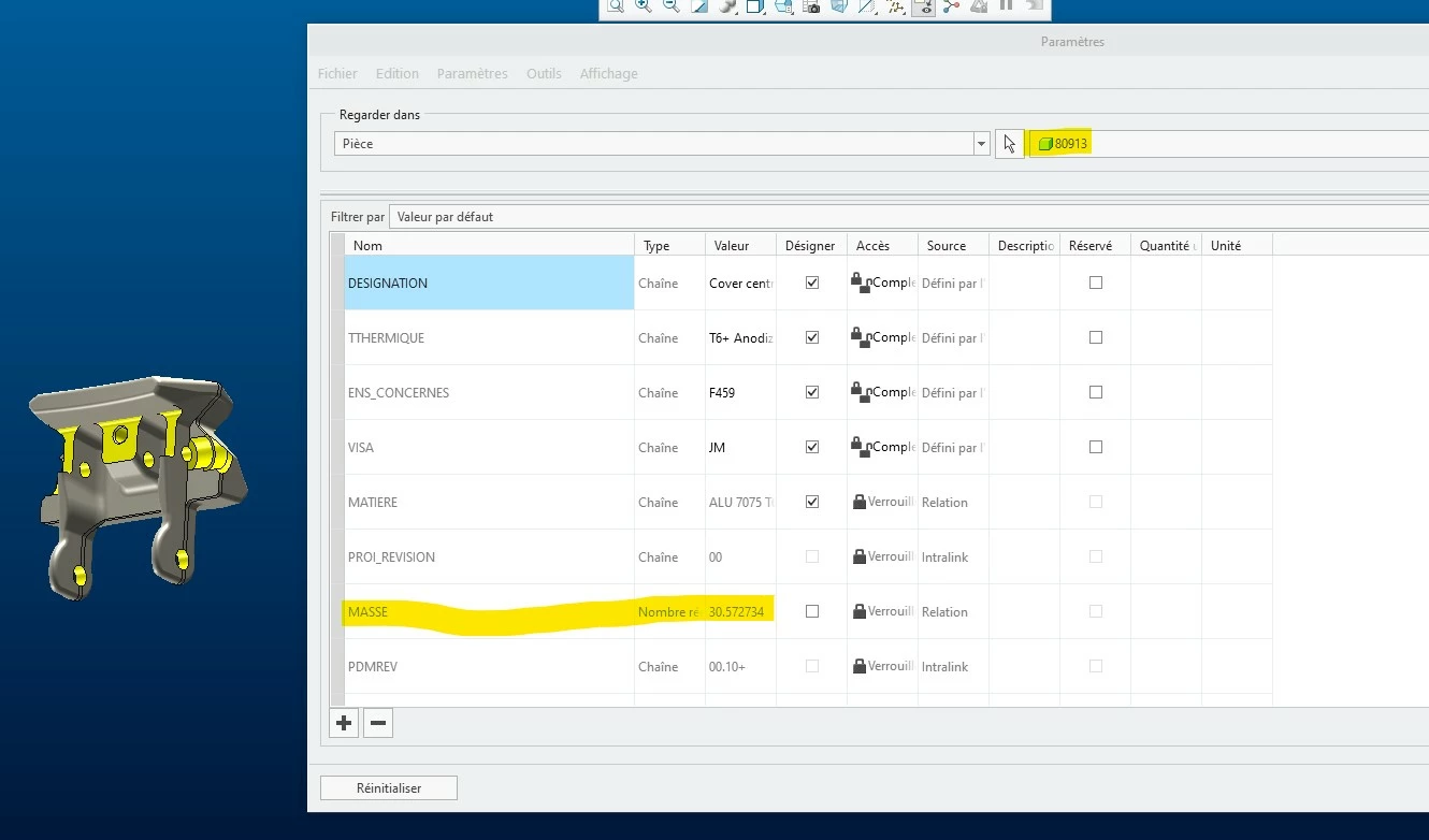

The weight of my part and this intance are different. But in my drawing I can't manage the different.
Do you have a solution to manage it?

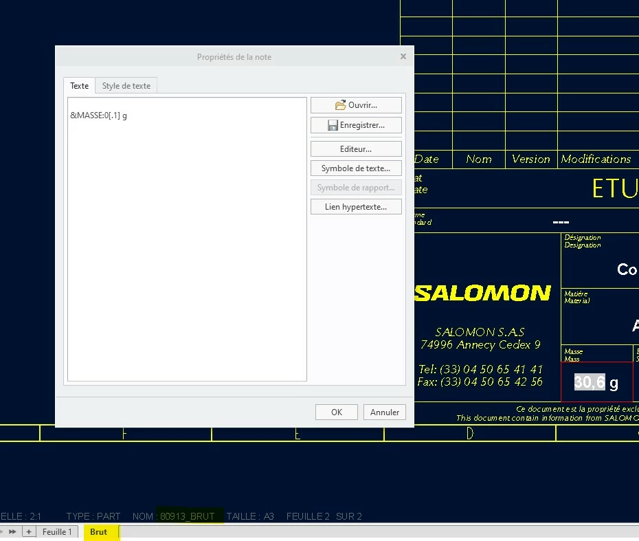

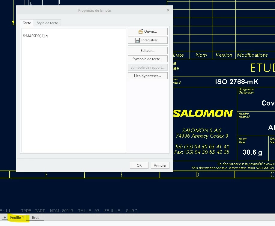

In the note calling out the mass value, you need to have the correct session ID. Every part or assembly, when in memory in Creo, has a unique session ID. It's an even number (0, 2, 4, ...) for parts, odd number (1, 3, 5, ...) for assemblies.
If both parts are being used in the same drawing, you make the part you're interested in the active one, then the note text you type is:
&MASSE[.1]g
Creo will append the correct Session ID to the end of the parameter name, like &MASSE:0[.1]g, &MASSE:2[.1]g, etc.
Once you do this it should work correctly for you.

3-Newcomer
Jul 9, 2024 11:55 AM UTC
Thanks a lot, that works perfectly
