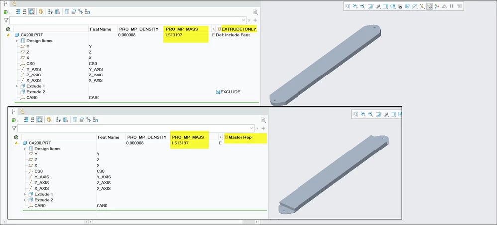

Jun 24, 2025 3:29 PM UTC
Does Multi-Body help solve this problem?   Has anybody tested the config setting in Creo 10?
Chris3
Jun 24, 2025 4:02 PM UTC
I tested with and without the config in 12.4.0.0 and there is no change. When a feature is removed in a rep, the mass properties still reports the master rep mass.
Someone can correct me if I am wrong, but I don't think working with bodies helps this issue. The part rep definition in Creo 12.4.0.0 hasn't changed and there is no option to create a rep using bodies (boolean features are hidden when you go into part rep definition).
Jun 24, 2025 5:57 PM UTC
It is wild that the mass doesn't change when geometry shown on the screen changes. 😞
